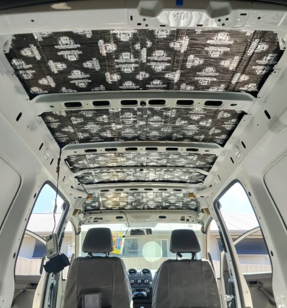

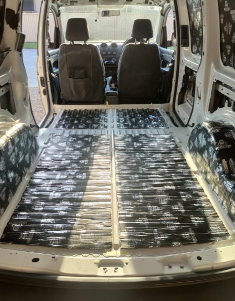

Here's a shot or two of mine also
Floor & sides
Floor & sides
Cardboard for my camper bed / storage etc
Roof
Roof
